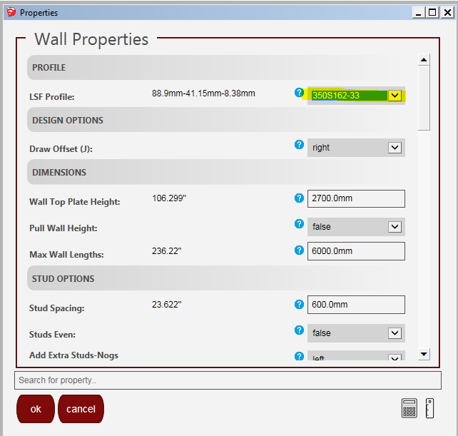

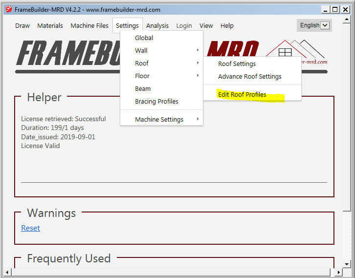

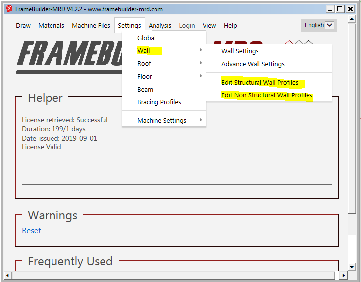

Add, remove or enable profiles by selecting the following menu option
Note: Profiles must be updated for each of the modules.

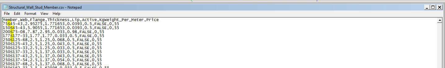

Editing the Profile List File
Note the following:
  • Make a backup of this file.
  • The first field is the name of the profile.
  • Maintain the format of the first field and the delimiters/separators. The "S" and "-" must be maintained. Correct Format Example 76S46-43 can be changed to 77S46-43.  An incorrect format 77A4643
  • All values are in inches.
  • Weight per length ratio and Price per Length must be set correctly for accurate reporting.
  • Enabled Profiles from All Modules Profiles List will also be available in the Free Tool Module.
Restart Sketchup and Verify if your Profile is now in the list.
