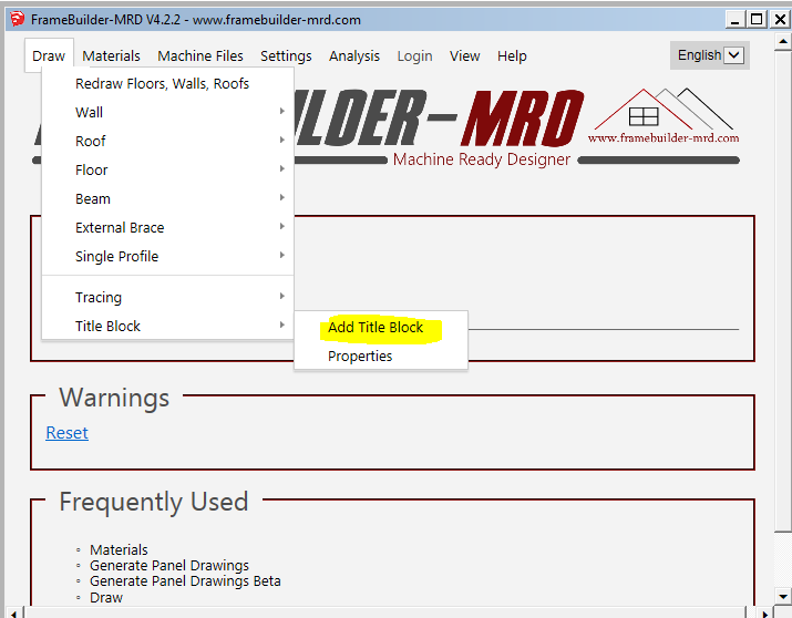

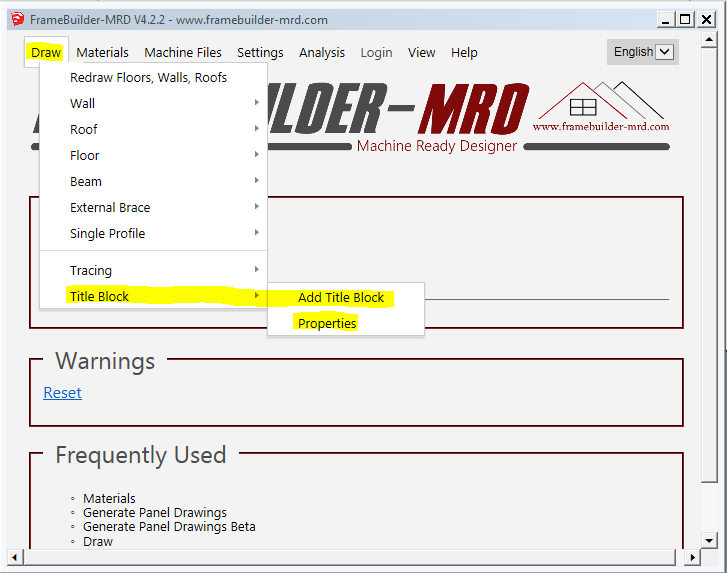

Step 1:
Access the Title Block tool and Edit Properties

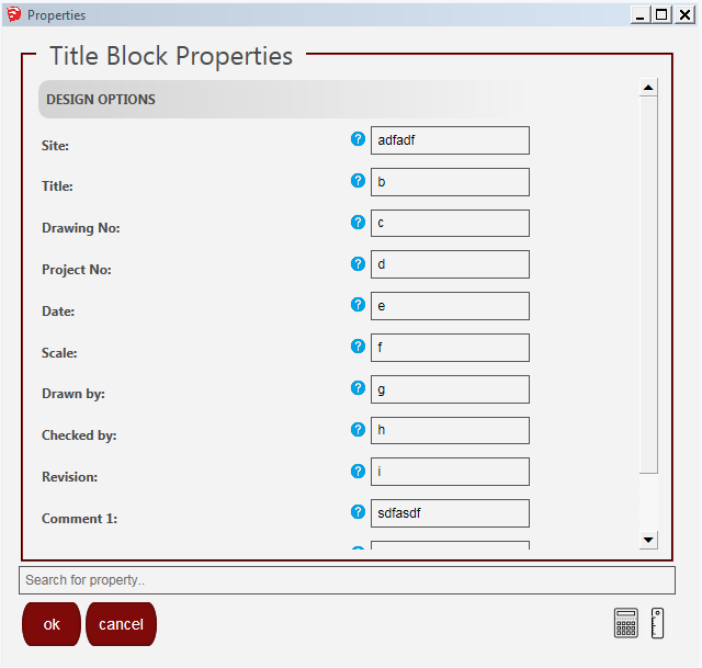

Step 2:
Edit Title Block Properties

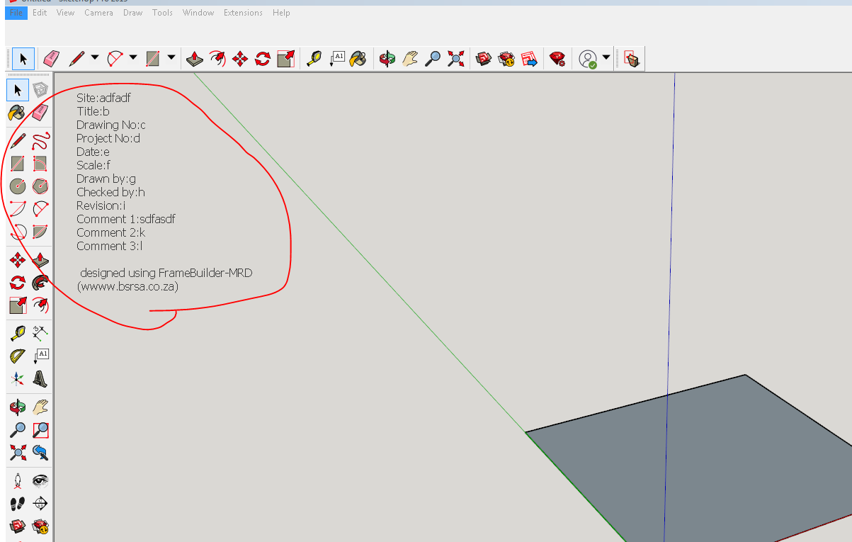

Step 3: Add Title Block to Sketchup model

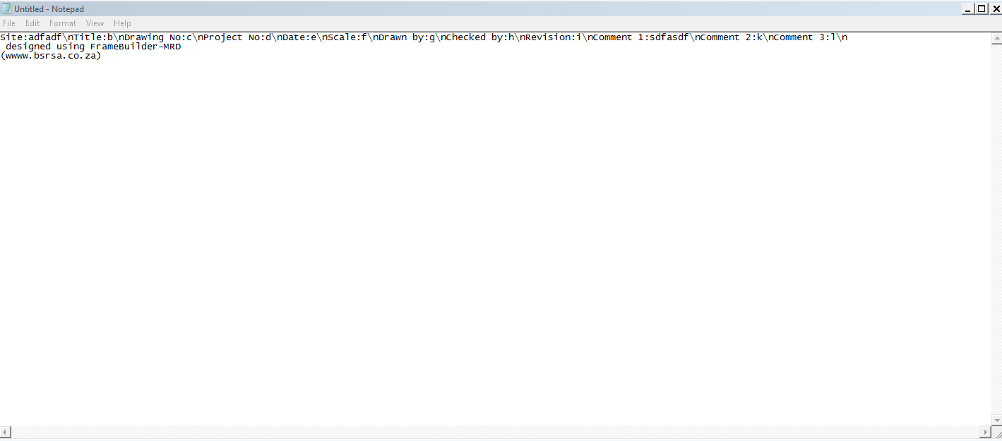

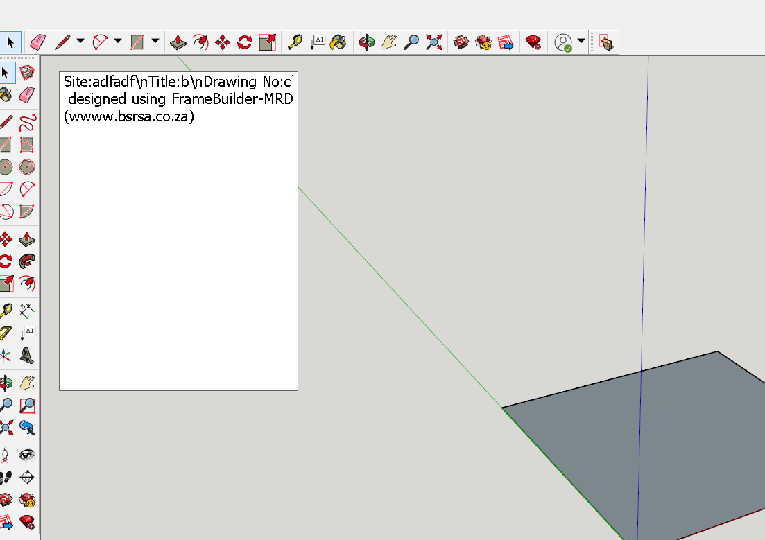

Double Click Title Block
Edit in Place or Copy Contents to Notepad, edit and replace back into field.
