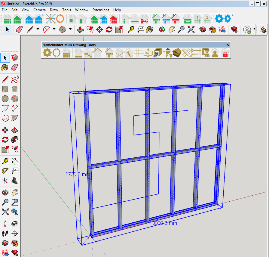

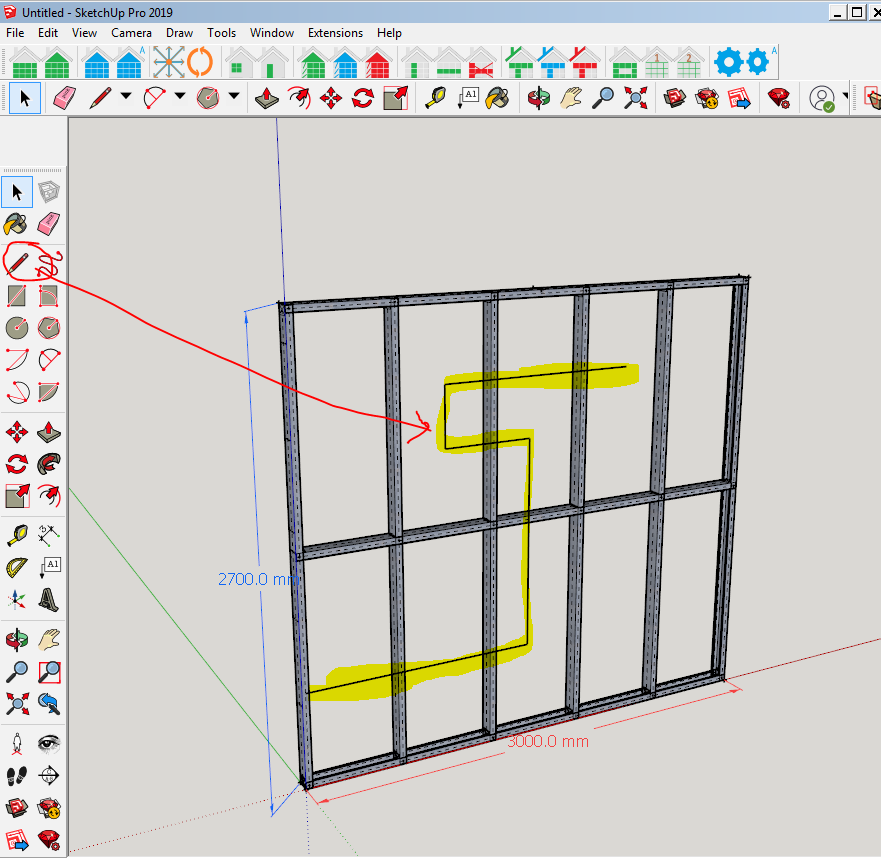

Step 1
Draw Reference Lines using pencil tool across the flange. The will follow the path of your plumbing or conduit.
Step 2
Select Lines and Wall

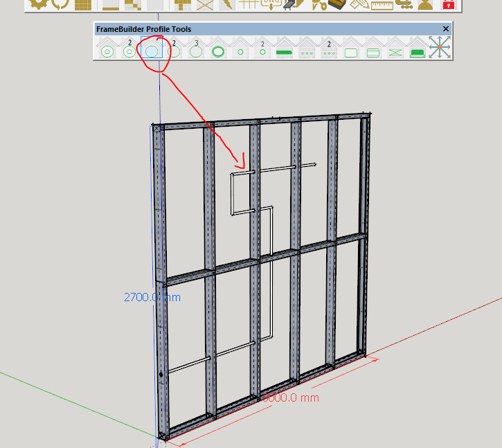

Step 3
Open up the Profile Toolset. Select the tool you wish to punch such as service hole.
