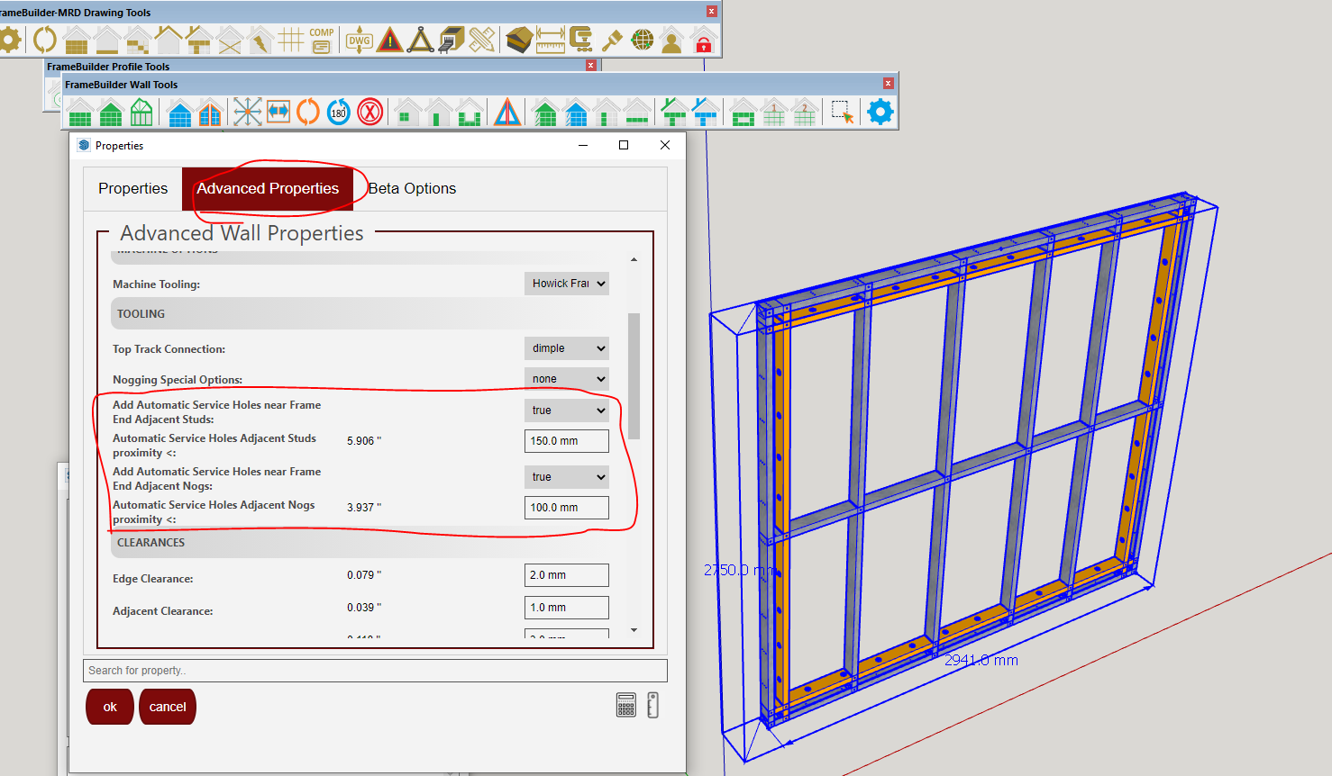

  • Option added to automatically add services holes to frame ends that have fixing tooling. This will make access to fixing points easier when there are nogs or studs that are too close to the ends.
