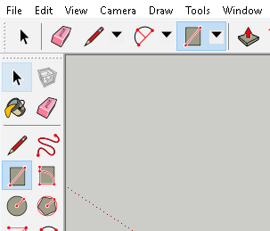

Step 1:
Create a floor plan or guide to follow by using the shape tool on sketch up.
Insert the dimensions according to the roof specifications.

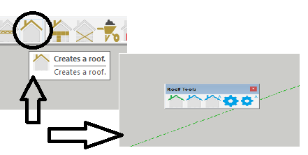

Step 2:
Click the roof icon as shown above (the tool bar on the left will pop up)
Click the Roof icon.
                                                       OR
On the menu go to Draw>Roof>Draw A Roof.

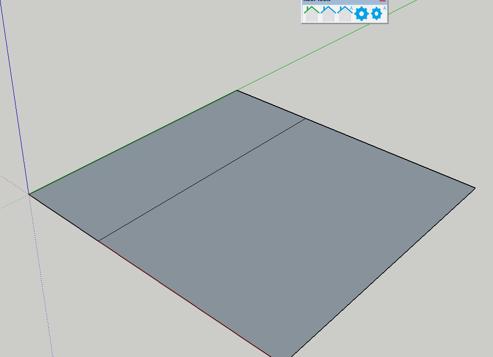

Step 3:
Roof Properties menu will pop up, choose and change around the settings to your specifications .
Choose between roof types
choose between truss types
Step 4:
Click with the cursor on the first corner then the second and then all the way to the end
                    The Roof Will be Drawn
