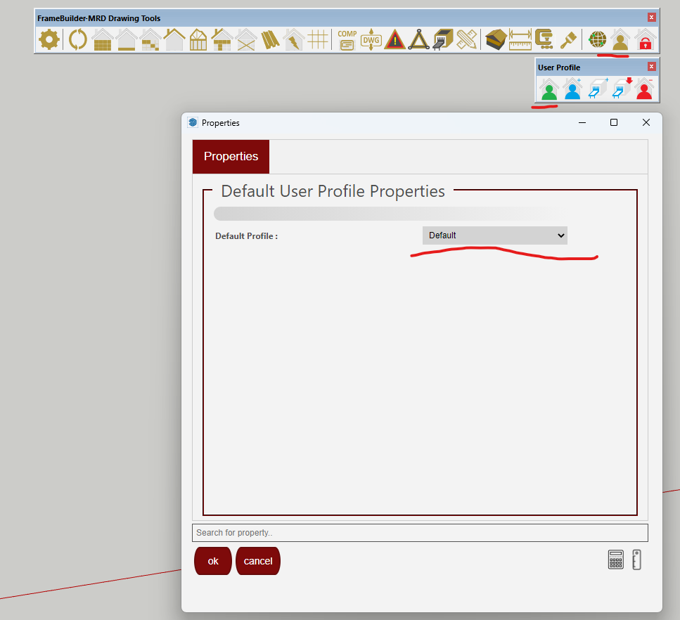

Step 1: Make sure your user profile is set to Default:

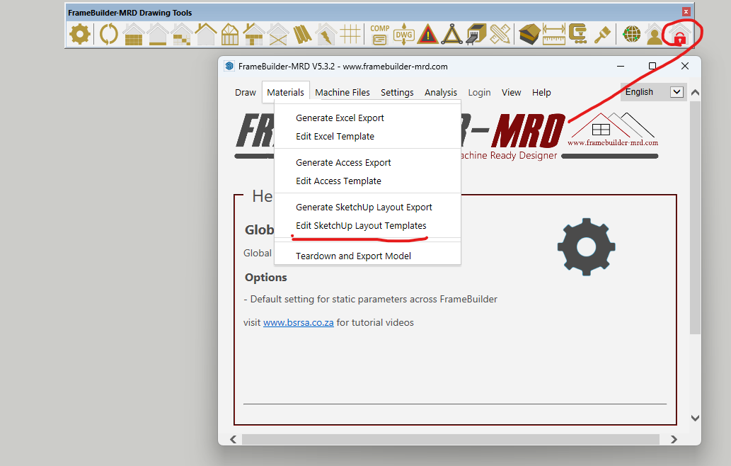

Step2: Open the main FrameBuilder-MRD Window and open the Sketchup Layout Location for your default user profile.

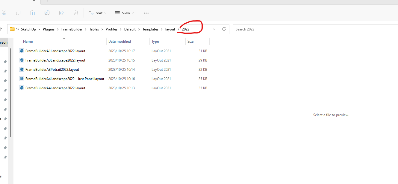

Once you click Edit Sketchup templates link. You should see a windows explorer folder with the location of your templates. Choose the folder that is inline with the version of Sketchup you are currently using. For Example, if you are using Sketchup 2022, open the sketchup 2022 folder.

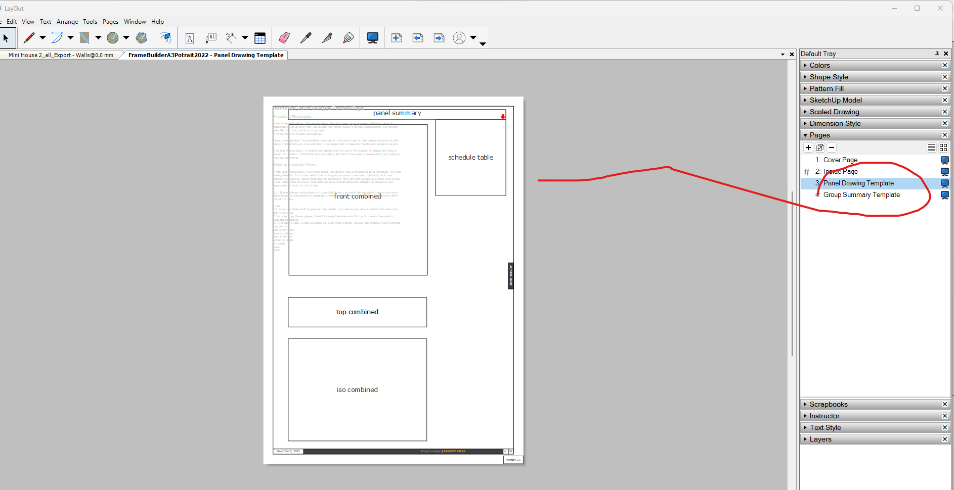

Step 4: Open anyone of the templates and look for the following two pages that determine the layout dimensions and views when processing your drawings.
Step 5: Select your customer user profile and following the same steps as above and open your template location and edit the template of your choice.  Create those two pages.  Panel Drawing Template and Global Summary Template. Copy elements from the default template to each of the pages you created in your custom templates. Make sure the version at the bottom of the page is also copied over.
