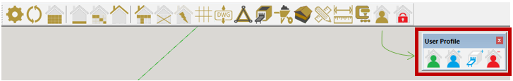

To get started click on the User Profile Icon on the main tool bar
A Second tool bar will appear with 4 Icons

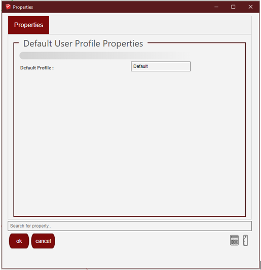

Select the first icon to set a default User Profile
A properties menu will open choose a User Profile and hit OK

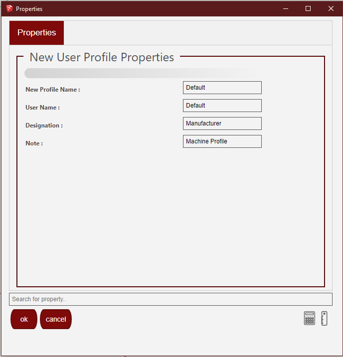

The second icon Creates a user profile
Once selected a properties menu will appear with all new user profile properties, configure accordingly and hit OK
A Pop-up message will appear to notify you that the user-profile has been created

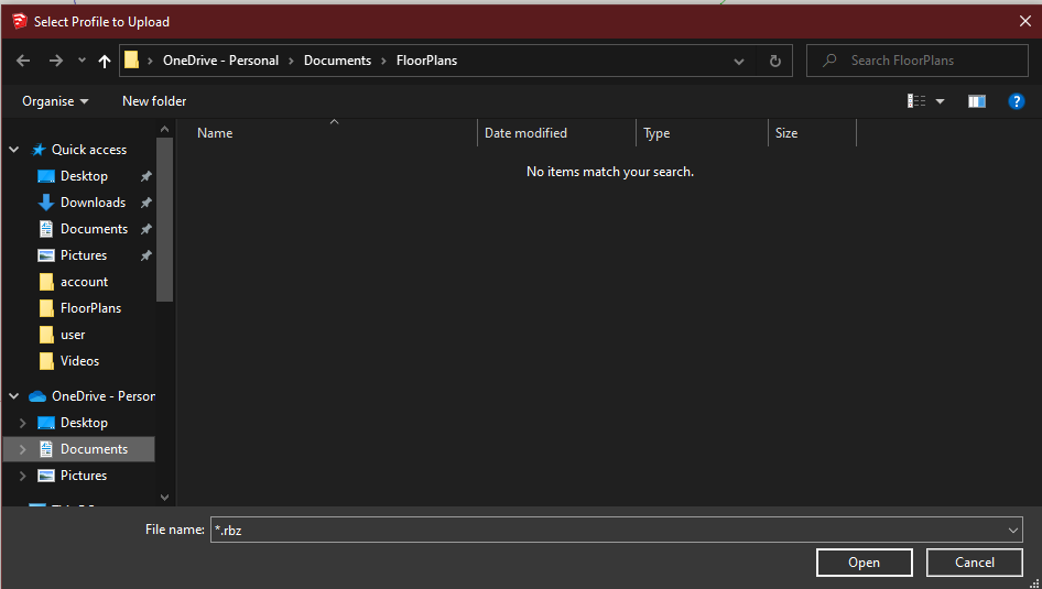

The third icon allows you to upload a user profile from your machine hard drive or a usb
Once selected your file explorer will open, locate your user profile (.rbz) and hit enter

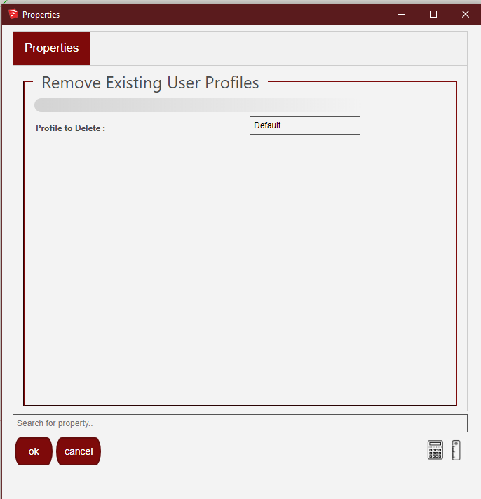

The fourth icon allows you to remove a user profile
Once selected a properties menu will appear for you to select a user profile that needs to be removed
A pop-up message will indicate that the specified user profile has been removed
