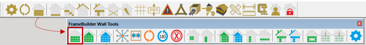

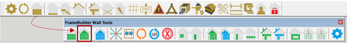

To Draw a Wall Select the Green Wall Tool on the Main Tool Bar.
To Draw a Wall Select the Add A wall Icon.

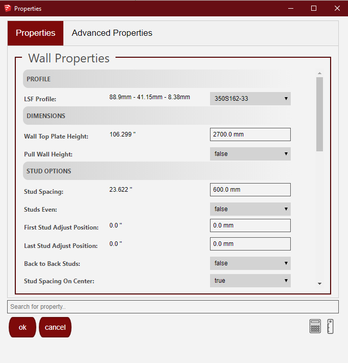

The Wall Properties Menu Will Pop up, if there is Properties to be Changed it can be Changed here, the Hit Enter.

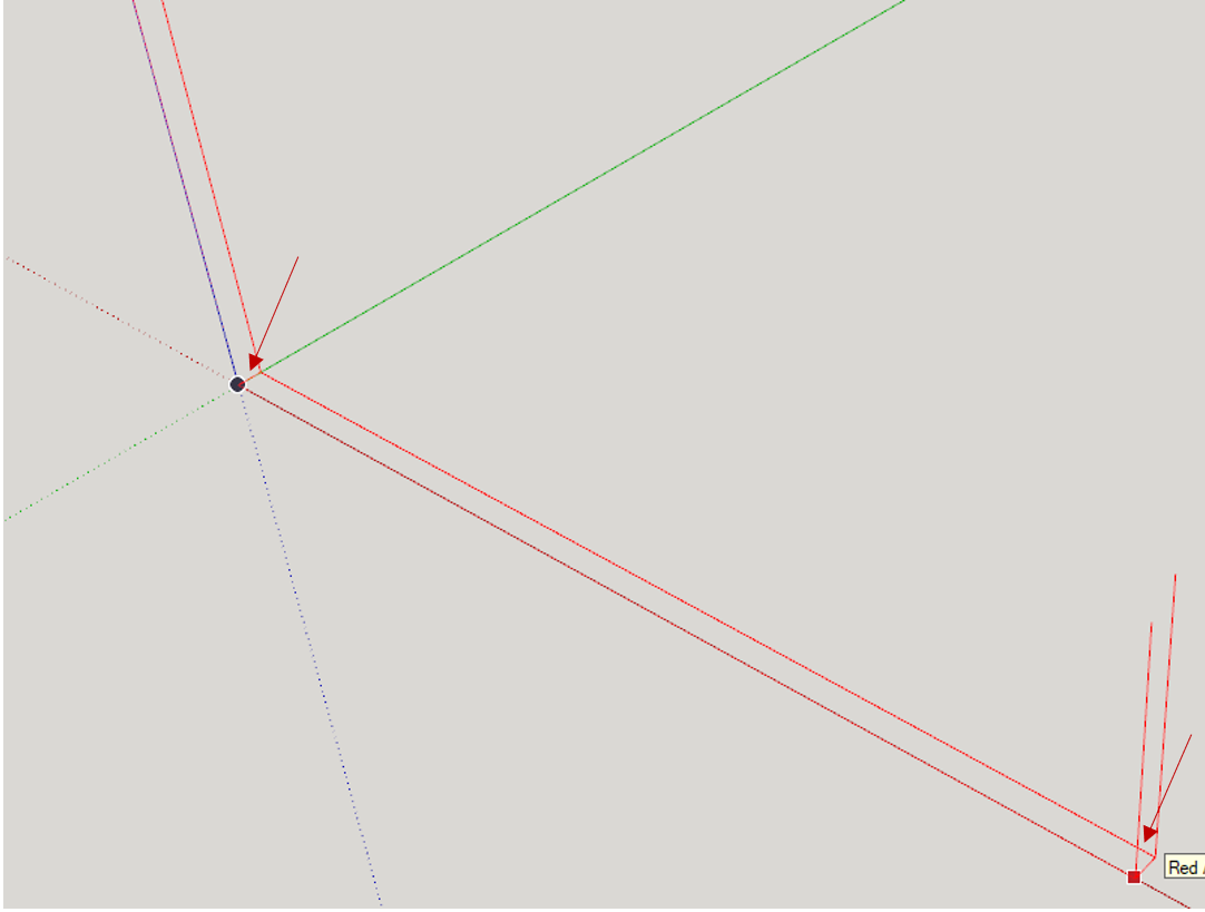

Select the Start and End Points for the Wall to Go.
After Selecting the Start and End Points the Wall will be Generated.

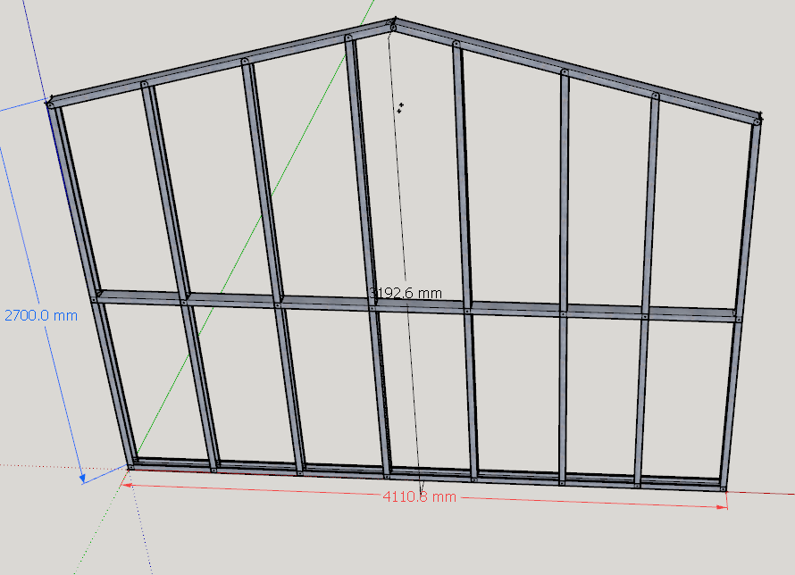

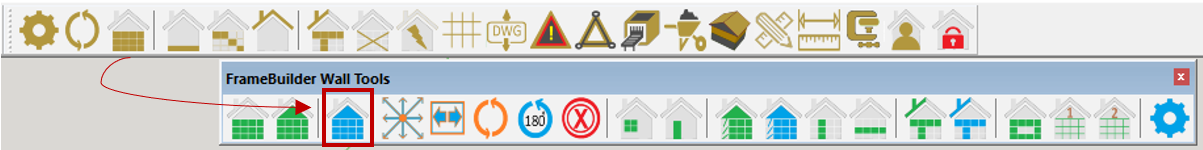

To Draw a Gable Wall its Similar to Drawing a Standard Wall.

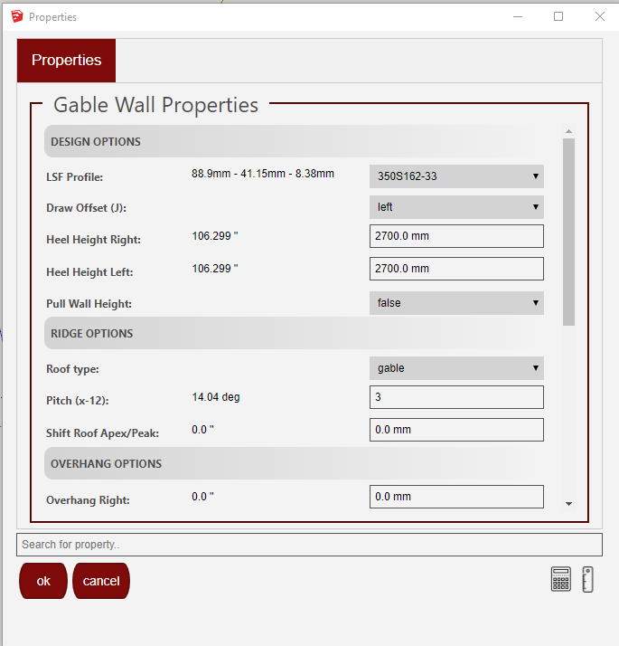

The Gable Wall Properties Menu Will Pop up, etc.
Select the Start and End Points for the Gable Wall to Go.
After Selecting the Start and End Points the Gable Wall will be Generated.
