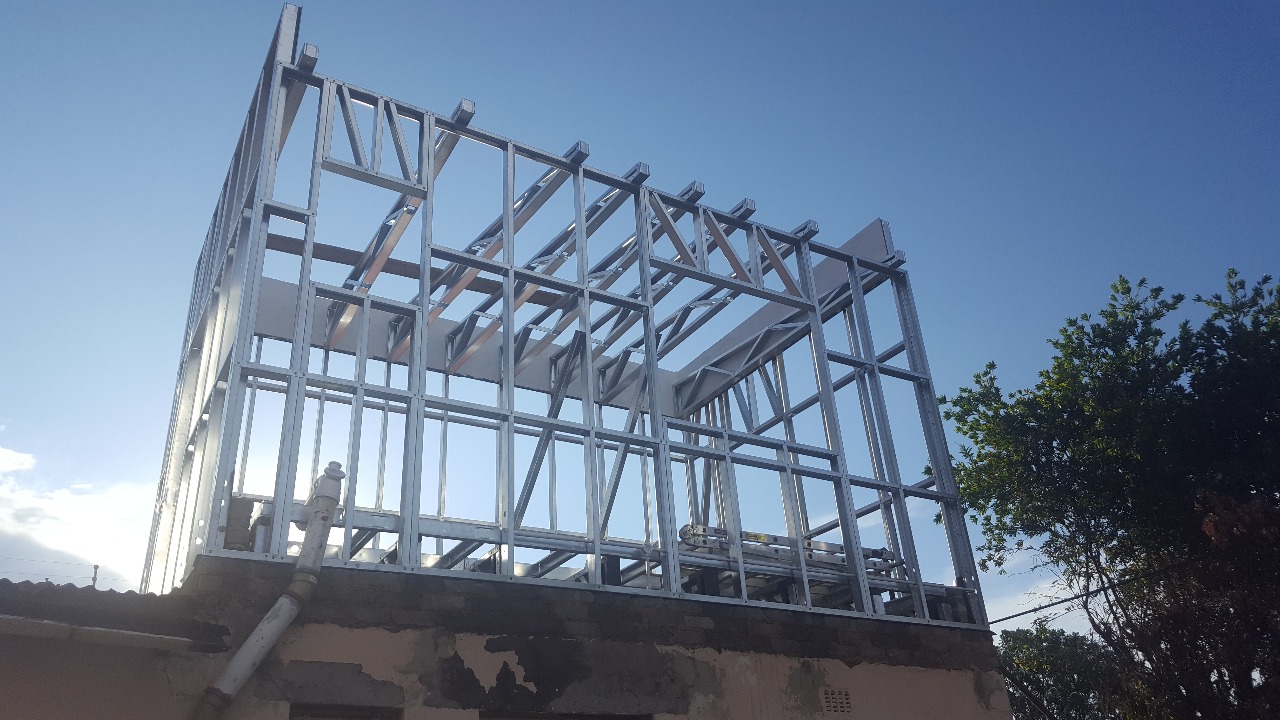

Image result for light gauge steel framing bsrsa
Lght Gauge Steel Structure For A Classroom.

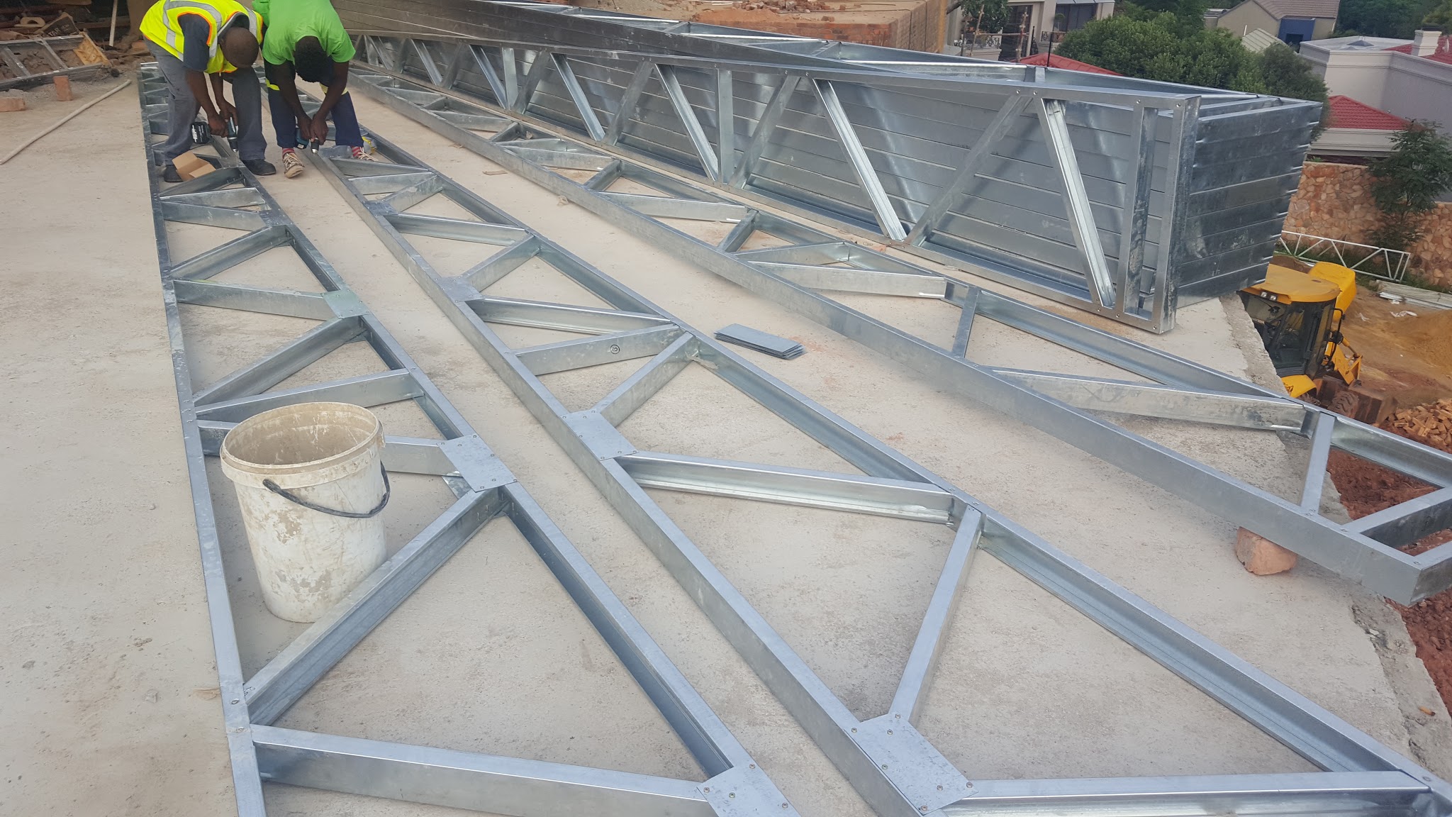

Light Gauge Steel Roof Trusses.
